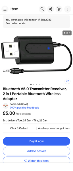

Anyway, thanks very much for your advice, I went with this very cheap £5 one from ebay to make sure it would work first. It works absolutely brilliantly and I'm now getting full use of my new smart sofa.
