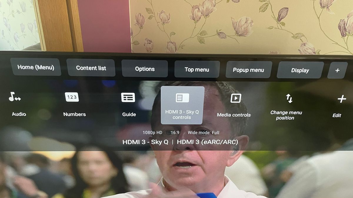

I have a Sony Bravia KD-50X80LU Remote Control and would like to control some features of a Sky Q.
If I press MENU on the Sony remote control, I get options called "Sky Q controls"
With options like Home, Options, Display etc...
Yet when I choose any of those menu options, nothing happens.
Have other people got any advice what to check here?
Has anyone managed to get these menu options to control their Sky Q box?

My Bravia Sync Settings options are.
Auto devices off is enabled
Auto TV on is enabled
I have enabled each device in the Bravis Sync device list
However, BRAVIA Sync control is not available and states "Not available while BRAVIA Sync compatible audio system is used"
I have a Sony HT-CT370 Soundbar fitted between the TV and the Sky Q box.
Linked via the eArc/ARC ports.
